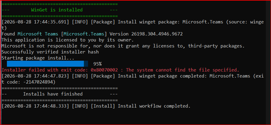

Error when MS TEAMs is installed with WINGET
I was trying to install MS TEAMs from the Install tab of CTT (version 26.08.19) and I get the following error:
Is there something I did wrong or is there something I am missing?

That error is coming from Windows’ own app installer, not WinUtil. WinUtil just triggers the same winget install command that Windows runs directly, and it installed fine when I tested it. This looks like something local to your machine’s app-install state rather than a broken Teams package :thinking:
Two things to try
  1. Open PowerShell and run
Repair-WingetPackageManager -Latest -Force
then try installing Teams again through WinUtil.
  1. If that doesn’t help, do you currently have Teams installed some other way (or did you previously and uninstall it)? A leftover partial install is a common cause of this exact error.

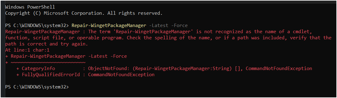

mewclouds, Thank you for your reply.
I tried running Repair-WingetPackageManager -Latest -Force and I get the follow error:
I am assuming I need to install something first before I can using this cmdlet?
It is possible I have TEAMs in a bad state. Is there a particular tool that will remove all the TEAMs garbage and allow me to reinstall?
David
mewclouds, OK after going down a dozen or so rabbit holes I finally got New TEAAMs to install using the TEAMs installer from the TEAMs website. Prior to that I used winget to force the uninstall of TEAMs and then used PowerShell to force the clearing of the TEAMs and AppInstaller cache. Thank you for all your help.
